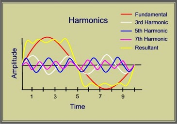

Fig. 1. Harmonics is demonstrated by the shape of a voltage or current waveform relative to its fundamental frequency.

Identifying and correcting harmonics and other power quality problems can lower energy costs and extend the useful life of electrical equipment. This occurs because harmonics can create uneven heating in electrical equipment, conductors, motors, etc. Simply put, harmonics are currents or voltages with frequencies that are integer multiples of the fundamental power frequency, which in the United States is 60 Hz. When waveforms deviate from a sinewave shape, they contain harmonics. Harmonics can best be described as the shape or characteristics of a voltage or current waveform relative to its fundamental (or base) frequency (Fig. 1).
As we will discuss in future parts of this series of articles, sophisticated power quality meters can measure the many harmonic frequencies that may be present, and that data can be used to design filters, such as LC (inductive/capacitive) or RLC (resistive/inductive/capacitive). The most common filter we see in commercial industrial facilities is a delta-wye step-down transformer that limits the pass-through of the larger 3rd and 5th harmonics back up to the higher voltage power system, reducing the effect of damaging harmonics on adjacent feeders, circuits, transformers and customers. As can be seen in Fig. 2, filtering can restore a very close to fundamental 60Hz sinewave, reducing the heating and other negative effects of harmonics.
