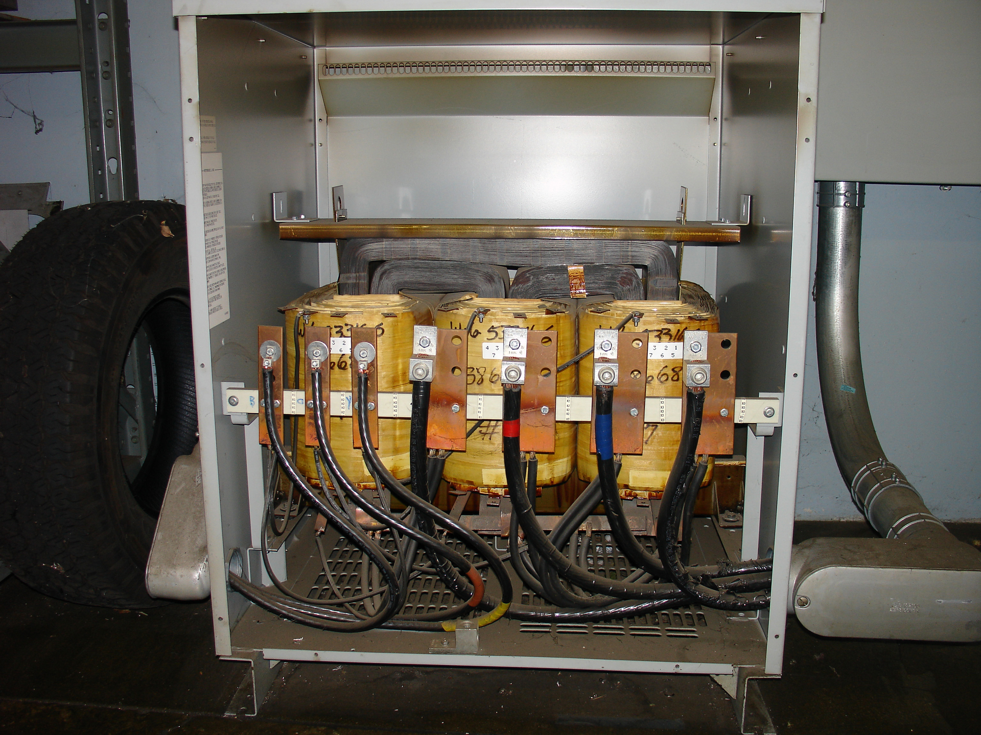

What happens when the manufacturer of a sensitive piece of equipment directs the electrician to not connect the equipment to the building’s grounding electrode system (GES)? This should raise a giant red flag to the electrician. If the NEC is the minimum requirement, then any design changes need to go beyond the NEC, not less than. Nevertheless, installations continue to be found where the electrician followed the manufacturers' requirements and left the equipment unsafe and the electrical system in peril.
In the Photo below, there is a major problem with the grounding of the transformer. See if you can spot it.
The neutral (XO) bus has not been properly grounded and bonded to earth through the GES of the building. The manufacturer of the sensitive equipment directed the electrician not to connect the neutral to the building’s GES. This misunderstanding of grounding by manufacturers has led to mischaracterizing all grounding systems and the proper connections required. Grounding is blamed for misoperations and damage to the equipment when it is not the root cause. Unfortunately, more damage is caused by not abiding by the minimum requirements of the NEC.
In the case of this transformer, it was serving a sensitive machine that was damaged when an electric utility’s underground cable failed nearby. Due to the proximity of the building to the faulted cable, the potential in the earth was elevated for a few cycles until the cable fault was cleared. This was long enough to change the voltage potential between the transformer and the sensitive machine, lowering the voltage significantly and melting down contactors and relays from the higher current draw. Since the neutral was not grounded properly and the machine was not connected to the GES, the voltage became unstable. In addition, there is no low impedance path for fault current return if anything were to happen downstream of the transformer secondary.
