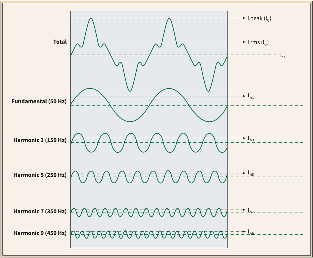

One of the most famous mathematicians/physicists — Jean-Baptiste Joseph Fourier (1768-1830) discovered the Fourier series. His great discovery states that any mathematical Fourier transform (FT) can be used to decompose a function of time (signal) into the frequencies that make it up. This means that a pure 60-Hz sinewave, which is the fundamental frequency, only contains the frequency 60 Hz. However, when a voltage sinewave becomes “bumpy” or “distorted,” it develops other frequencies that can be decomposed into harmonics of the fundamental frequency.
The use of non-linear electrical elements — inductors and capacitors — on our power system causes shifts in the current with respect to the voltage. These elements (or components) can also cause irregularities in the current and voltage with respect to their wave shapes. These irregularities are sudden changes in any part of the waveform. How do they affect the waveform in real life? They add (or subtract) other sine (or cosine) waveforms (in the case our fundamental is a sinewave) of other frequencies (harmonics) from the total waveform. These harmonics are mathematically described by the Fourier series.
When you add electronic loads to the mix as you have on the grid, the voltage and current waveforms become even more distorted. The old saying, “The voltage belongs to the electric utility, and the current belongs to the customer,” is helpful here. When you place electronic loads on the grid, the power system has a difficult time supplying current at the harmonic frequencies required by the electronic loads. What happens is the voltage supply (e.g., transformers) is limited as to how much energy they can provide at these harmonic frequencies in addition to supplying the fundamental (50 Hz or 60 Hz) frequency at the same time. When the current becomes distorted, the voltage becomes distorted as well because of energy limitations at the harmonic frequencies. Figure 1 illustrates an example of a 50-Hz current sinewave with four of its harmonics (3rd, 5th, 7th and 9th) as well as the total (all five waveforms added together) at the top.
