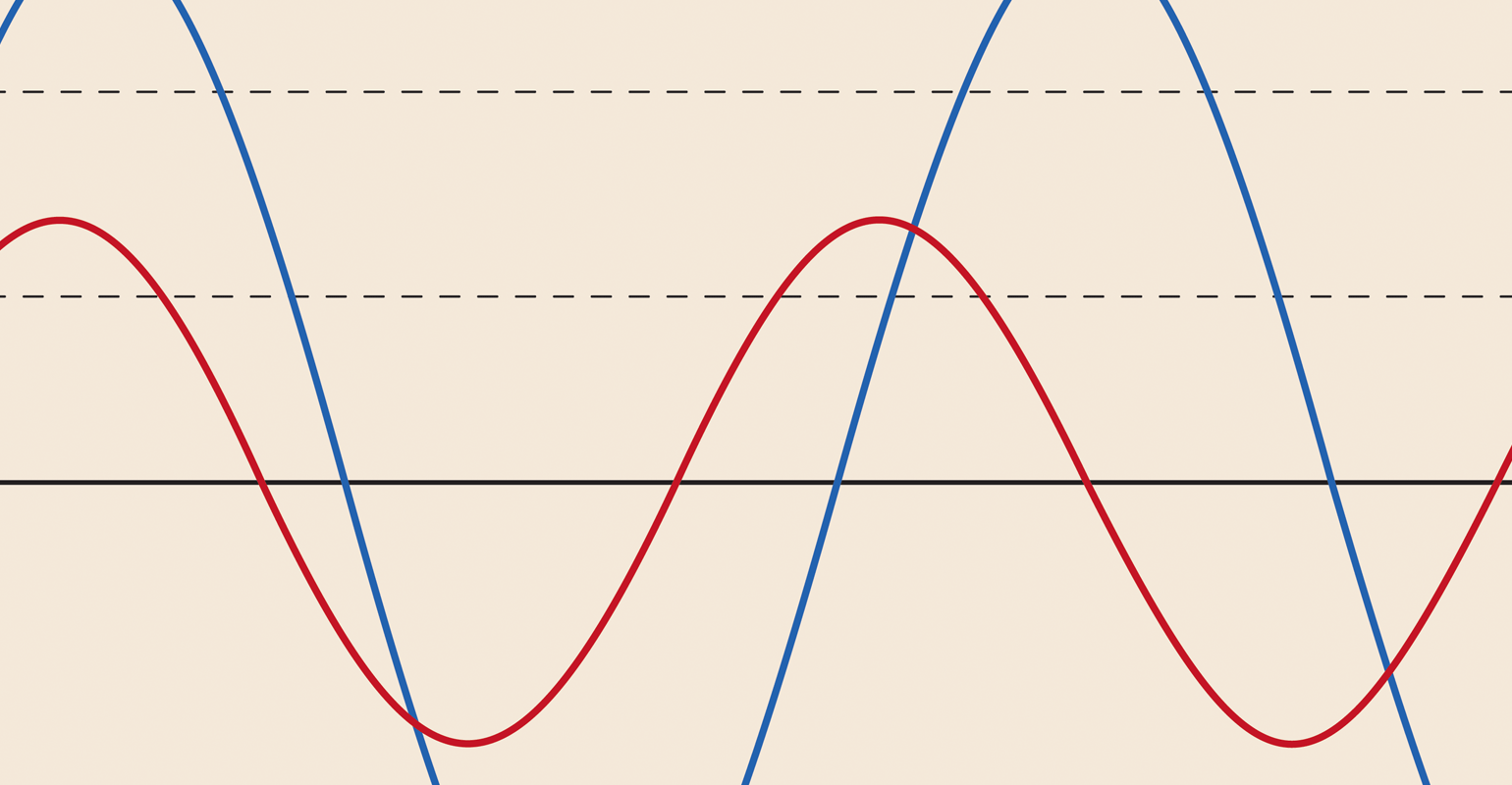

However, with respect to power frequency shifts, frequency is the most important defining term. The standard power frequency in the United States is 60 Hz, which means the stimulus (i.e., voltage sine wave) changes (i.e., completes its mathematical period) 60 times per second. (The old terminology is 60 cycles per second.) Many foreign countries use 50 Hz as their standard power system frequency. Figure 1 illustrates an example of both 50-Hz and 60-Hz voltage sine waves.
