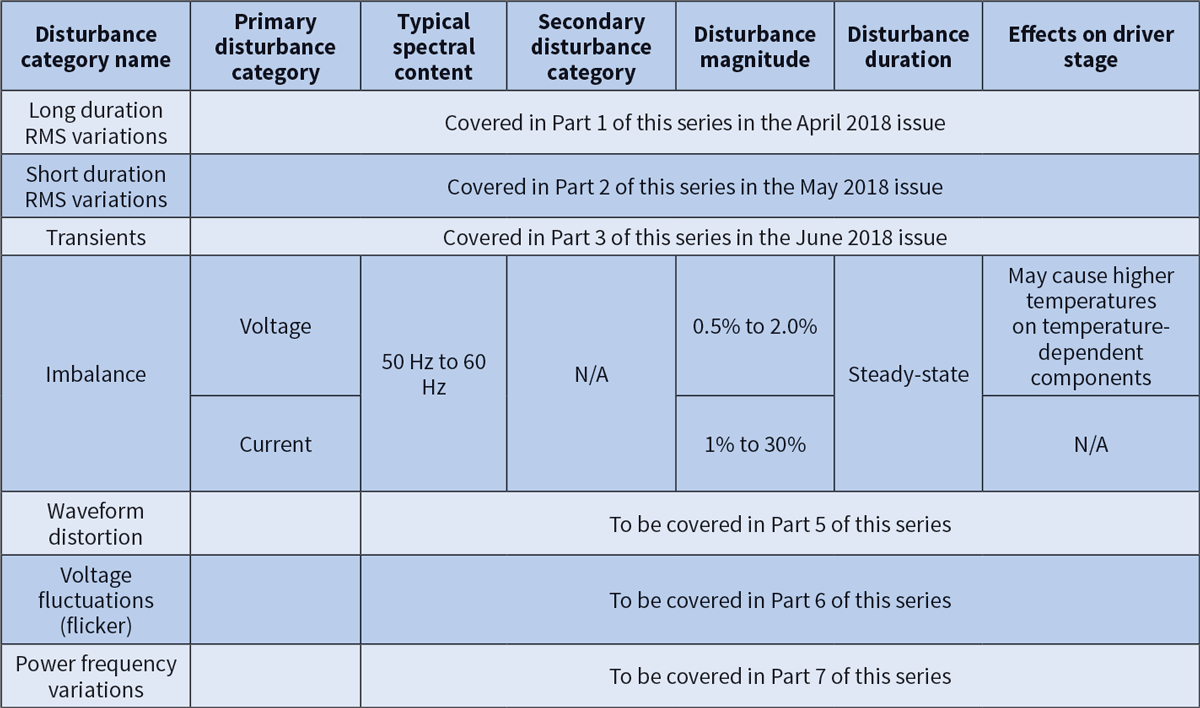

The Table provides the category breakdown and all technical specifications for the voltage and current imbalances discussed above.
