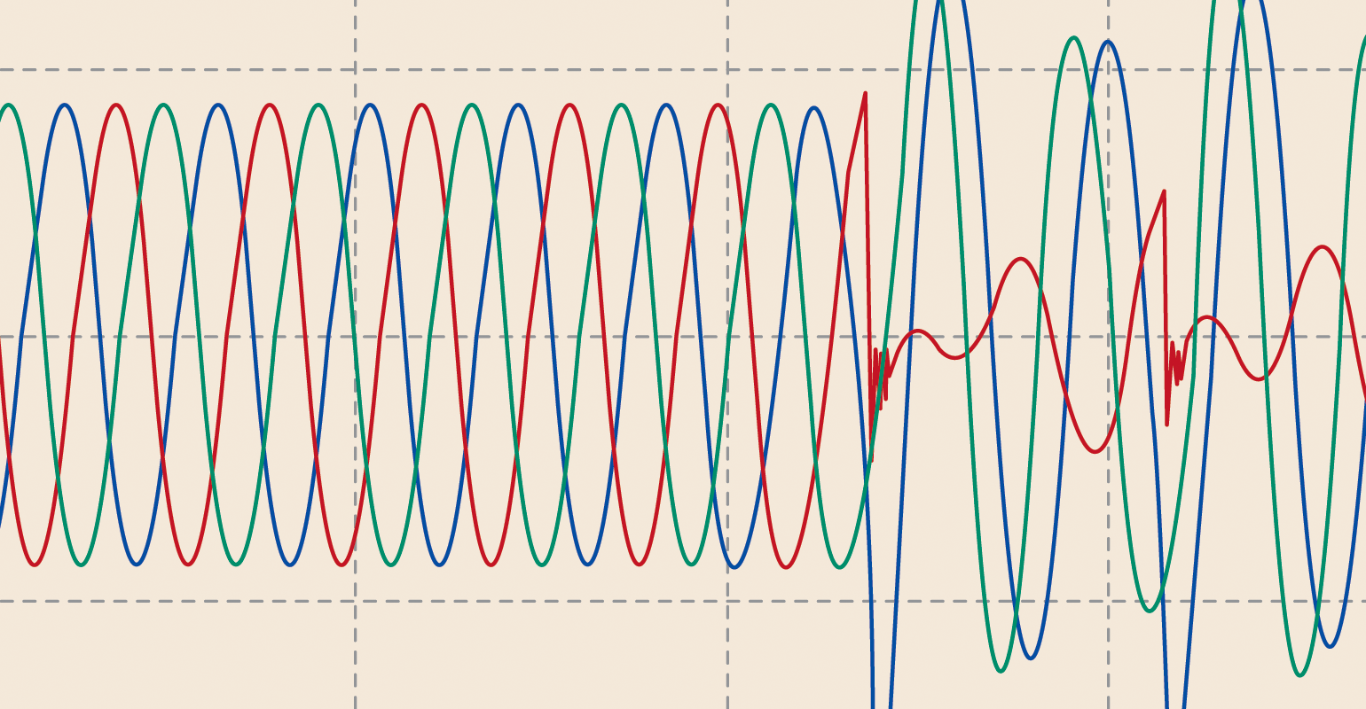

Figure 1A illustrates a typical voltage swell that occurs on the unfaulted phases close to a single line-to-ground fault on an overhead power distribution system. Notice here that the AC line voltage rose to almost 1.4 p.u. on Phase A (red) with a duration of about 0.65 sec (or 39 cycles) followed by a voltage sag to near zero voltage. Figure 1B illustrates 9-cycle voltage swells on Phases A and B followed by voltage sags on Phase C that occurred on a customer’s medium-voltage power distribution bus. These swells are not symmetrical about the zero-voltage axis. Here, the swell on Phase A was higher than on Phase B. The swell then experienced some transient voltage conditions. The sags on Phase C also show some transient voltage conditions mixed with the sags.
