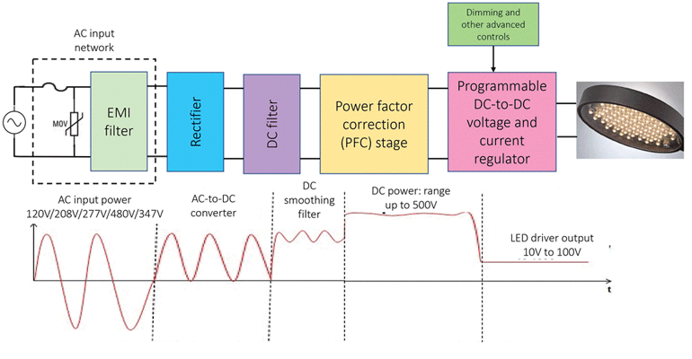

Figure 1 illustrates a typical simplified block diagram for a programmable LED driver with its basic voltage waveforms. The AC input voltage is applied to the AC input network, which consists of the AC line fuse and some form of a surge protection network. The surge protection network here consists of one MOV (most LED drivers use only one MOV). The next stage is the bridge rectifier. This stage rectifies the AC input voltage. The third stage is the DC smoothing capacitor, which is typically two electrolytic capacitors. The fourth stage is the power factor correction (PFC) stage. The PFC stage is responsible for detecting the shape of the AC input current and the amount of phase shift between the AC input voltage and the current. The PFC stage is typically where the first power electronic transistor in the circuit is located.
The PFC stage is where energy is first stored in the driver circuit for the purposes of converting AC power to DC power. The PFC stage is also responsible for keeping the DC output voltage constant when the AC input voltage varies. However, its primary function is to correct the power factor on the AC input. It does this by sampling the waveform of the AC input current and comparing it to the AC voltage waveform. The AC input voltage has a much truer sinusoidal shape than the distorted and shifted AC input current. The PFC circuit “shifts” the AC input current back as close to the AC input voltage as possible. This corrects the displacement power factor (DPF). The PFC circuit also “fills in” the missing parts of the AC input current waveform. This corrects the power factor related to distortion — harmonic distortion of the current. The product of the DPF and harmonics-related power factor is called the true power factor (TPF). The objective of the PFC stage is to provide a TPF as close to unity as possible, which controls harmonic currents required by the driver.
The fifth stage is the DC-to-DC converter, which provides voltage and current regulation necessary to operate the LED array — or LED light engine. Over the last few years, this stage has become programmable. Using a programmable DC-to-DC converter allows the manufacturer to minimize the number of power converters while maximizing the number of LED light engines that one converter can operate. Voltage and current levels are programmable. Feedback from the LED light engine is provided back to the converter. Moreover, customer controls, such as dimming and LED tuning (i.e., varying the color of light that the LEDs generate), are “piped in” to the programmable converter as well. Hence, you can see that the programmable converter requires a lot of programmable digital components and circuitry to provide the type of lighting control customers desire as they improve the overall performance of their electronic-based lighting system.
