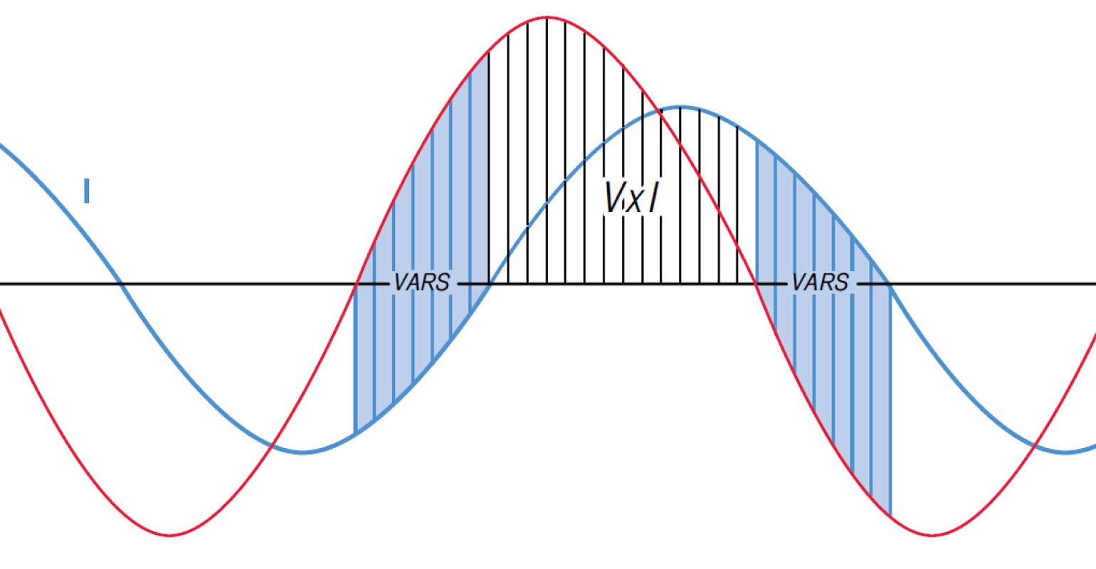

The DPF is the “power factor” of just the 60-Hz portion of the waveform for voltage and current. Harmonic effects are inherently excluded from the calculation and have no direct effect on the result. DPF is computed as the cosine of the phase angle between the current and voltage fundamental sine waves:
DPF = cos
Figure 1 shows a sample voltage (red) and current (blue) waveform, where the current is shifted in phase from the voltage. This phase shift is typically caused by inductive loads such as motors. Instantaneous real power is the voltage times the current. Portions of the waveforms where the V × I product is positive contribute to positive real power flow (energy delivered to the load), while negative values represent reactive power, which subtracts from the net real power over a 60-Hz cycle. If there is no phase shift, the V × I product is always positive, and every sample contributes to the real power. On the other hand, if the phase shift is 90°, the positive values exactly cancel with the negative values, and no real power is delivered. The familiar power triangle relations quantify this effect (Fig. 2).
