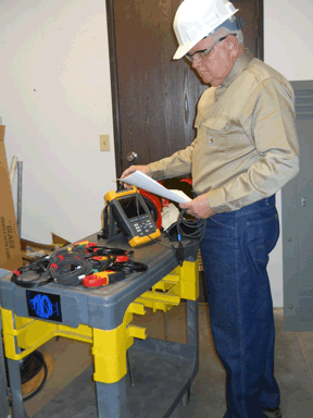

Conducting a power quality survey begins with planning. Simply determine the purpose of the survey, and write it down in a notebook or binder that will be used throughout the process to organize and maintain data. Start with a good one-line diagram of the facility electrical distribution system. If one does not exist, then this is an excellent time to get one up to date.
If conducting a general power quality survey to obtain baseline data for future comparisons — or to help identify any immediate hidden electrical distribution problems that may exist — start monitoring as close as practical at the point of service. Beware, however, measuring near the service typically means large amounts of fault current available. Therefore, be careful when connecting the analyzer at a point in the distribution system downstream of the main breaker that limits incident energy levels to acceptable values. Because power quality problems can either come from the electric utility — or be generated within the facility — be sure to contact the utility in order to identify any possible issues on this side of the meter.
Inside the facility, continue to “drill down” into the distribution system following the one-line diagram. Obtain data at the source of each separately derived system. For example, take recordings at the first panelboard or switchboard after a 480V to 208Y/120V transformer. Be sure to mark up drawings, and take plenty of notes for future reference.
Digital cameras work well for quickly capturing nameplate data and later identifying exact connection locations. Note plant conditions and any equipment that was running. Print out digital pictures, and maintain all data for the survey in the notebook binder. These notes will become valuable when analyzing data and conducting further studies.
Follow manufacturer’s instructions for connecting and setting up the analyzer. Because of the amount of test equipment and supporting documentation that is needed, it is often best to have an equipment cart dedicated for power quality work. In addition to technical expertise, the underlying key to a successful survey is planning and organization. Three common mistakes when connecting power quality analyzers are:
  1. Failure to observe current polarity. Make sure the arrow on current clamps points toward the load. If the arrow points in the wrong direction, a negative current value is obtained on the analyzer for that phase.
  2. Not matching current/voltage probes. If analyzer input phase “A” is clipped onto phase “B,” it is obvious readings will be erroneous. Color code individual leads such that voltage and current leads for each phase are the same color, and connect carefully to prevent such errors.
  3. Relying on battery power to complete a lengthy monitoring session. While fully charged analyzer batteries are meant to last hours, nothing is more frustrating than to find key power quality events were not recorded because the analyzer shut down. Be sure to keep the analyzer plugged into an AC source for recording parameters when you will be away from the equipment.
