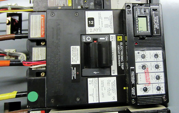

Photo 3. Notice how someone wrote “2MP” on the label. It was mounted in space No. 12.
Notice the sticker “12” in Photo 3. Also note that someone penned in “2MP” on the label. This breaker supplied Panel 2MP and was mounted in space No. 12. These were the original factory labels. Now observe the wire harness entering the breaker case. This is where the CT output is delivered to the breaker microprocessor; following that wiring harness will lead to a neutral terminal bus that runs through a CT. The system neutral for the sub feed must be connected to that terminal; otherwise, the microprocessor will sense no neutral current whatsoever.

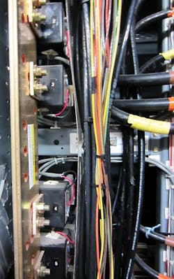

Photo 5. Note the manufacturer installed current transformer locations. There is no neutral feeder connection on CT3. In addition, the neutral feeder to 3MP wasn’t moved from CT4 to CT3 when the phase feeders were moved to breaker No. 3.
My search led me to an orderly layout of neutral terminals positioned in proximity to nearby breaker slots in each cabinet (Photo 5). I found neutral Terminal No. 12; it was without a neutral conductor connection — bare and unused (Photo 6). No wonder the microprocessor read zero neutral current. The CT associated with space No. 12 had nothing to sense! Where then, is the sub feed neutral from Panel 2MP connected?

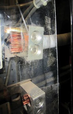

Photo 6. Terminal No. 12 (where the neutral for 2MP was supposed to be connected) was bare.
They say hindsight is 20/20. I had gained critical understanding that now aided me in this diagnostic endeavor. In removing the dead fronts of the switchgear, the problem was revealed (Photo 7). In fact, now it was clear as day.
