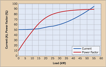

Electric motors connected to the power line are the main reason for reduced PF. The rated PF of a standard motor depends on its rated power and, typically, is around .85. However, it can be much lower if the motor is lightly loaded (Fig. 1).
Fig. 1. Graph of line current and power factor of a 55kW AC
induction motor as funtion of its load.

To produce the required rotating torque and speed, an induction motor takes both active current and reactive current from the power supply. The rotating torque of the motor is created as an interaction between the active current component and the magnetic field. The field is produced by the reactive current component. Light load takes less active current, but the magnetic field, as well as the reactive current, stays constant. This means that the power factor decreases with decreasing load. The current is mainly active at the full load but mainly reactive at the light load.

The losses in the power line, transformers, and cables are proportional to the square of the current. You can estimate this as follows. Assume the average load on the 55kW motor is 35kW. From Fig. 1, the motor current at 35kW is 65A. The AC drive input current under these conditions is 60A.
The AC drive reduces the input current from 65A to 60A. The reduction of losses when operating the motor from an AC drive is described by the following equation:
If total losses on the supply side are 5% of the average load, the AC drive can reduce these losses to about 4%. Remember, the usual reason to install an AC drive isn't for PF improvement but for better process controls, energy savings in the process, and/or reduced wear of the machinery. PF improvement is a positive side effect.
