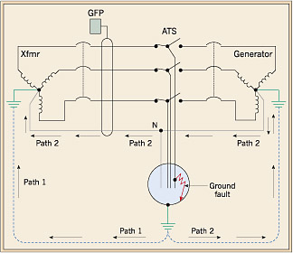

Problems from multiple neutral-to-ground connections. Two major problems arise from these connections.
Incomplete ground-fault sensing. Consider a 3-pole transfer switch with zero-sequence GFP at the service, as shown in Fig. 1. Suppose a fault occurs between one of the phase conductors and the metallic conduit enclosing these conductors. The resulting ground-fault current has two paths it can follow in returning to the transformer neutral.
Path 1 is directly back to the transformer along the equipment grounding conductor. Path 2 is along the equipment grounding conductor to the point where the gen-set is grounded, then to the gen-set neutral, and finally along the neutral conductor back to the transformer neutral.
Keep in mind that a zero-sequence GFP acts when it senses a predetermined value of current imbalance. So, the current following Path 2 will pass through the transformer GFP sensor just as though it were normal load current, and the zero-sequence GFP will sense only the fault current following Path 1. As a result, you would have incomplete sensing of the total fault current.
Nuisance tripping. Now, consider a 3-pole transfer switch and zero-sequence GFP with an unbalanced load, as shown in Fig. 2. Again, the unbalanced current in the neutral has two paths to follow. Path 1 is directly to the service neutral. Path 2 is to the gen-set neutral, through the gen-set grounding electrode and — by way of metallic equipment enclosures, conduit, fittings, etc. — back to the service neutral.
The current through Path 2 would have the same effect on the ground-fault sensor as ground-fault current. Therefore, an unbalanced load would affect the sensitivity of the GFP sensor and could cause it to trip the breaker even though a fault or short-circuit current does not exist.
The problem with both GFP connections discussed above is that the neutrals of the transformer and gen-set are tied together in the transfer switch. There are three possible solutions to overcome the above-mentioned problems.
Solution 1: 4-pole transfer switch. This type of transfer switch provides complete isolation of service and gen-set neutral conductors, thereby eliminating both improper sensing and nuisance tripping caused by multiple neutral-to-ground connections. Fig. 3 shows how the 4-pole transfer switch provides isolation in the event of a ground fault. As you can see, there is only one way the fault current can get back to the transformer neutral. With the neutrals thus isolated, you can add conventional GFP to the gen-set output.
