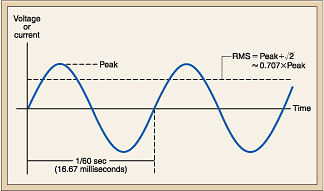

One key parameter derived from the two values mentioned above is crest factor, which is the ratio of the peak value to the root-mean-square (rms) value of a waveform. This is expressed by the equation C = XPEAK ÷ XRMS. For a pure sine wave (Figure), the peak is 1.0, and the rms value is 0.707. Thus, the crest factor of a pure sine wave is 1.414 (1.0 ÷ 0.707).
It's interesting to note that crest factor is also an important parameter in mechanical systems. According to the paper, “What is ‘Crest Factor’ and Why Use It,” by Alan Friedman of DLI Engineering, Bainbridge Island, Wash., crest factor can indicate rolling element bearing wear, gear tooth wear, or cavitation. Quite often, it's trended over time to see if the amount of impacting is increasing or not.
DC voltages have a crest factor of 1.0, because the rms and peak amplitudes are equal. It's the same for a square wave (50% duty cycle). For a triangle wave, it's 1.73. Crest factors for other waveforms are shown in the Table (click here to see Table). As you can see, crest factor is a dimensionless quantity.
