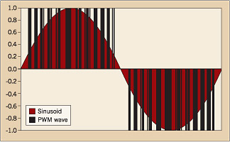

Fig. 1. An ideal sinuosoid and PWM waveform figure.

Pulse-width modulation (PWM) VFDs are most commonly used in industry because of excellent input power factor due to fixed DC bus voltage, no motor cogging, higher efficiencies, and lower cost. A PWM VFD uses a series of voltage pulses of different lengths to simulate a sinusoidal wave (Fig. 1 on page 8). Ideally, the pulses are timed so that the time average integral of the drive yields a perfect sinusoid. The current method of choice to produce this waveform runs a triangle wave and sine wave through a comparator, and outputs a voltage pulse whenever the sine wave's value is greater than the triangle wave. The current electric component of choice to generate the voltage pulse is the insulated gate bipolar transistor (IGBT), although silicon-controlled rectifiers (SCRs) can work as well. In the near future, injection-enhanced gate transistors (IEGTs) will be used to perform this task. Much more long term, memristors will probably become the component of choice for this task.

Fig. 2. A real sinusoid and PWM waveform. Note how the harmonics affect the shape of the sinusoid.
Heating is only one of the problems with VFDs. The other major problem lies with system harmonics. A picture of the PWM and the harmonics they cause is shown in Fig. 2. The irregularities in the sine wave are called harmonics. In an ideal power circuit world, these harmonics should not exist. They do nothing but cause problems. Fortunately, there are a number of ways to mitigate harmonics.
