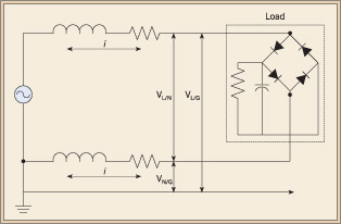

Figure 1 shows a simple diagram of a single-phase load connected to a voltage source. As the load draws current, a voltage drop develops across the supply and return conductors. N-G voltage measurements at the load will reflect the voltage drop across the return (neutral) conductor.
The National Electrical Code, in Sec. 210.19(A), FPN No.4, states: “Conductors for branch circuits as defined in Art. 100, sized to prevent a voltage drop exceeding 3% at the farthest outlet of power, heating, and lighting loads, or combination of such loads, and where the maximum total voltage drop on both feeders and branch circuits to the farthest outlet does not exceed 5%, provide reasonable efficiency of operation.” This amounts to a 6V drop in a 120V branch-circuit home run. Assuming equal losses in the supply and return conductors, then you should see an N-G voltage of 3V, which is a realistic condition.
