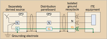

Figure 1 is an example of a typical low-voltage power system using IG receptacles, as allowed by the NEC. Note that the ground terminal of the receptacle is not connected to the conduit grounding system at the receptacle. Instead, an IG wire is connected to the receptacle ground terminal and is routed with the power conductors, passing through one or more panelboards, remaining insulated from the metal conduit and enclosure grounding system until its termination at the power system grounding point (at the service entrance or separately derived source, as shown in this example).
IG wiring and ground-fault current
It's just as important that the IG wiring provide an effective ground-fault path from the connected equipment back to the power source. If a ground fault were to occur at the load equipment, the IG grounding system would provide an effective ground path, as shown in Fig. 2. The IG conductor is permanent and continuous, has ample current capacity — because it's sized according to NEC requirements — and has a low enough impedance path to allow the overcurrent protective device (OPD) to clear the ground fault.

Unsafe and incorrect IG wiring
Sometimes, IG requirements are misinterpreted, and IG circuits are thought to be truly isolated. Efforts are wrongly made to ensure that the sensitive equipment-grounding conductor is connected to an isolated dedicated ground and is never to be connected to the “dirty” power ground. Figure 4 is an example of just such an incorrect interpretation of an IG. Here, the ground terminals of IG receptacles are collected at an IG busbar and are then connected to a separate earth grounding electrode.
Sometimes, extraordinary attempts are made to ensure a good connection to the earth for the dedicated grounding electrode in the hopes of providing a “quiet ground” for some sensitive electronic system. Despite the good intentions of the isolated IG approach shown in Figure 4, it fails to meet the basic safety requirements of the grounding system. This “isolated IG” approach does not provide the effective ground path required by the NEC and results in an unsafe and hazardous condition.
Consider the possibility of a ground fault occurring at the load equipment, as depicted in Fig. 5. Note that an effective ground path is not provided between the isolated, dedicated ground and the power source grounding electrode system. It is not known if the ground path between these two earth electrodes is permanent and continuous or of ample current-carrying capacity. Furthermore, the ground path surely does not have a low enough impedance to allow the OPD to clear the ground fault quickly and safely. The impedance of ground electrode connections to earth is measured in ohms, while the required ground-fault path impedance must be in the milliohms.
Additionally, any difference in potential occurring between the isolated dedicated ground electrode and the power system grounding electrode (which must exist because one is referred to as the “quiet” ground and the other as the “dirty” ground) will appear as a common-mode (N-G) voltage at the load equipment. Although the original intent of this isolated IG approach is to reduce electrical noise, the result is actually an increase in the common-mode noise potentials at the sensitive loads.
Significant ground potential differences can occur whenever there are large ground currents flowing, such as during ground faults, lightning, or even when electrical storm clouds (charged) move over the area. A common result of incorrect isolated IG wiring during these events is damage to the connected load equipment.
One interesting observation of incorrect and unsafe grounding practices is that the equipment may still operate even though it's improperly grounded — and the safety hazard may occur only under a specific set of conditions, such as during a ground fault or a lightning storm.
Perhaps the term “isolated ground” contributes to the misinterpretation of the IG wiring techniques. A better term would be “insulated ground,” because the intent of IG is not to isolate the ground of the sensitive load from the power system ground, but rather to insulate it and to control where the connection to the power system ground is made.
