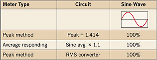

Methods of meter calculations. All digital multimeters (DMMs) are calibrated to give rms indication. However, depending on the voltage or current signal you're measuring, the different methods used in instruments to calculate rms value may yield vastly different measurements.
Let's look at the most popular types to see how they arrive at rms values.
  • Peak method
    Meters using this method read the peak of the measured signal and divide the result by 1.414 to obtain rms value of that signal. So, if the signal waveform is undistorted, this method gives relatively accurate measurements.
  • Averaging method
    With this method, a meter determines the average value of a rectified signal. For a clean sinusoidal signal, it relates to the rms value by the constant “k” (1.1). As with the peak method, it gives accurate measurements if there's no waveform distortion.
  • True rms-sensing method
    This method uses an rms converter that does a digital calculation of rms value. It squares the signal on a sample-by-sample basis, averages the result, and takes the square root of the result. It gives accurate measurements, regardless of waveform distortion.
