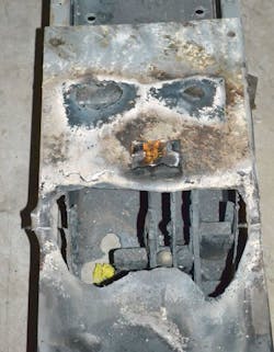

Photo 3. This 800A vertical busway section was installed in a multi-story apartment building. A distressed “face” was melted into the enclosure after it was involved in a major arcing ground fault event.
With busway, you can see there are many accessible points-of-entry into the raceway for liquid contaminants to penetrate and contact uninsulated, energized conductors. This is why it is important to prevent liquid spills near or onto busway. Liquid spills are especially disastrous when the liquid runs down a vertically installed busway in a multi-story building application (Photo 3). Because of these vulnerabilities, busway has maintenance requirements specified by the manufacturer and organizations such as the National Electrical Manufacturers Association (NEMA).
Arcing ground faults on busway, related to not following the manufacturer’s and NEMA’s maintenance recommendations, have resulted in huge property and electrical equipment losses. In addition, catastrophic business losses typically occur due to fire and sprinkler-water damage.

A recent analysis by Hartford Steam Boiler Inspection and Insurance Company indicates that there have been many failures of vertically run busway installations in multi-story buildings. Other horizontally run busways have also failed when subjected to long-term water or other contamination sources (Photo 4).

Busway is typically sized for large ampacities (i.e., thousands of amperes). In older buildings, occasionally the busway size is reduced along the run without using overcurrent protection at this transition. An electrical short or arcing ground-fault on the lower-ampacity busway section is protected by overcurrent devices sized for the larger-ampacity busway. The lack of equipment ground fault protective devices (GFPEs) and the oversized circuit protection can cause substantial melting of the smaller busway conductors and enclosures.
When major damage occurs from arcing ground faults on busway, it is sometimes difficult to find replacement sections for obsolete busway model numbers. In many cases, it may be more cost-effective to replace the entire vertical busway riser compared to having custom transitions and sections made to replace those that were damaged. Because the busway itself is typically designed to be the major method of distributing the building power to the more distant building locations, it is important to make sure this electrical “super-highway” is properly inspected and maintained. A failure on the busway typically means a catastrophic loss of power to a large portion of the building.
Photo 8. Arcing ground faults on busway are likely to be an amperage magnitude that is less than the trip points of the overcurrent protective devices. Complete failure of the busway can occur when this happens.
An arcing ground fault on a busway can cause a long sustained equipment melting condition. This is because the amperage flowing through the ionized air arc-path is limited by its own resistance through the plasma cloud. The relatively large overcurrent protection device for the busway does not know that the energy of the arcing ground fault is not a normal load on the large ampacity busway. As a result, the busway fuses or breakers do not open, and the arcing ground fault clears when the equipment or the busway melts away (Photo 8).
