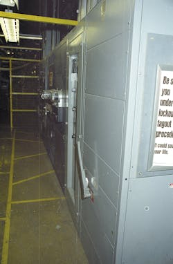

The local power utility supplied 480/277V 3-phase electrical service to the facility through a 1,500kVA, pad-mount transformer located on the north side of the building. The service entrance conductors fed into a 3,000A, 480/277V, 3-phase disconnect. In this case, the disconnect was a manually operated, spring-loaded bolted contact switch with quick-positive switching action. A nameplate date code showed it was manufactured in 1969.
The switch was located in the main switchgear area along the interior north wall, as shown in Photo 1. Feeder conductors traveled from the switch output buses to various disconnects and subpanels located in the main switchgear area. The production equipment motors and conveyor drives used in the factory were then fed from these subpanels.

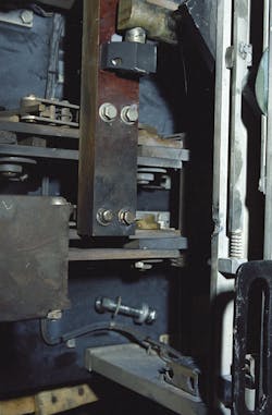

Troubleshooting the situation, one electrician decided to use a long flat-headed screwdriver as leverage to try and force the switch fully closed. After wedging the tip of the screwdriver between the dead-front panel and the switch arm, he pulled down on the screwdriver handle, using it as a lever to achieve the force necessary to close the switch. As he pressed down on the handle, the tip of the screwdriver slipped through a gap between the switch and the dead-front panel, making contact with a bolt on one of the upper left phase buses inside the panel while the shaft was touching the grounded portion of the switch arm assembly.
This act initiated a direct phase-to-ground short (see Photos 2A, 2B, 2C), resulting in an intense arc blast. Fortunately for the electrician, the main force of the blast shunted downward and was partially blocked by the dead-front panel. Because he was holding onto the insulated screwdriver handle, he was not shocked. However, he was shaken and temporarily blinded for a few hours by the flash of light generated in the arcing event.

Electrically, the arc blast created severe problems for the packaging facility. Molten metal ejected from the arcing event damaged the feeder connections and conductors at the output of the switch. This apparently created a secondary phase-to-phase arcing event between the left and center phases (Photo 3). This arcing event apparently caused an overload on the utility transformer, resulting in one of the phases shorting out. The facility was left without power until the electric utility could replace the transformer.

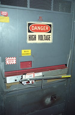

The third contractor completely replaced the switch. However, at the time of our scene visit, they had not yet replaced the original dead-front panel with one that properly fit the new switch (Photo 5). Instead, they temporarily covered the openings with a thin layer of cardboard and tape. Although the switchgear area appeared to be cordoned off into a controlled access area, they could have blocked the panelboard opening with sheet metal or a non-combustible, insulating material.
