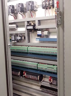

Photo 1. This process control panel for a laboratory was installed by Pieper Electric, Inc., Milwaukee. The lab has a bay for all of the production/process activities. That bay is a Class I, Div. II location with about 250 valves and sensors. All I/O is passed through the intrinsic safety barriers. The IS isolators are the green modules that are lit up. Wires from these modules pass through the duct with the blue cover (Photo courtesy of Phoenix Contact, Inc.).

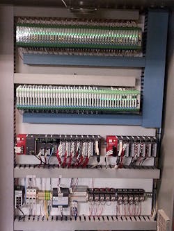

Photo 2. This is a panel at a manufacturing facility owned by DNP IMS America, Mount Pleasant, Pa. This panel is for a mixing control system that provides ink to the ribbon coating line. The IS isolators are used on all the circuits coming in from (and going out to) the hazardous locations (Photo courtesy of Phoenix Contact, Inc.).

Applying the raceway, cable tray, and cable rules is pretty straightforward; just run IS conductors in their own raceway, cable tray, or cable. But what happens when these get to an enclosure? How do you keep them separated? How do you secure them to prevent contact? You can see solutions to these and other problems in the Photos. In addition to correctly using application-specific panel systems and isolators, the installers executed superior workmanship.
