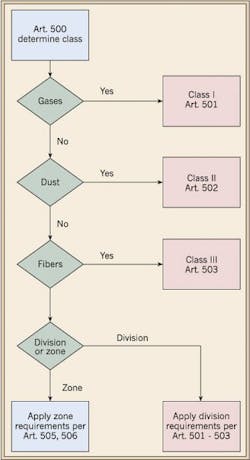

The NEC arranges flammability properties into Class I, II, and III, in Art. 501, 502, and 503, respectively. It defines and describes these in Art. 500 (OSHA also defines and describes these). Art. 500 is the basis for all hazardous location work and the related Articles that follow it (see Figure).
This flowchart helps you determine the appropriate Articles and Sections of the NEC to apply when designing and installing equipment in hazardous locations of a facility.
You don’t use Art. 500 by itself; you always pair it with at least one other in the series. All hazardous locations come under Art. 500. Then the requirements are modified according to Class (and then further modified according to additional breakdowns).

You won’t find the definition of a Class I, II, or III location in Sec. 500.2, because that definition isn’t specific to Art. 500. However, it’s not in Art. 100 either. Instead, turn to Sec. 500.5. There, you’ll find that 500.5(A) requires you to classify locations based on the properties of flammables or combustibles present (or likely to be present). It also provides a short definition of each:
• 500.5(B). Class I: Flammable gases. Art. 501.
• 500.5(C). Class II: Combustible dust. Art 502.
• 500.5(D). Class III: Easily ignitable fibers/flyings. Art 503.

In Art. 500, 501, 502, and 503, Class I, II, and III locations are further broken down into Divisions. The simplified version is a given Class will be either:
• Division 1: The ignitables are significantly present under normal conditions.
• Division 2: The ignitables are significantly present under abnormal conditions.
You’ll find more nuanced descriptions of Division 1 and Division 2 for Class I, II, and III respectively in 500.5(B), (C), and (D).
In Art. 505, the NEC presents a zone classification system as an alternative to the Class I division classification system in Art. 500. In Art. 506, the NEC presents a zone classification system as an alternative to the division classification system in Art. 500, 502, and 503.
Correctly determining the Class and then the Division or Zone is critical to correctly applying the requirements for a given hazardous location. Obviously, sealing against gases (Class I) is more difficult than sealing against fibers (Class III). Whether the ignitables are normally present in concentrations high enough to present a combustion hazard (Division or Zone) also bears upon what measures you need to take to prevent the ignition of flammables and the spread of combustion.

You can think of Art. 500, 501, 502, and 503 as a set of Articles that detail the requirements for hazardous locations. Art. 505 and 506 provide alternative requirements to the Division system of those other Articles.
Given that structure, Art. 504 could be viewed as being out of sequence. It provides the requirements for a special kind of circuit that can be used in hazardous locations. That circuit is “intrinsically safe,” meaning it can’t create a spark or thermal effect capable of igniting the flammable gas-air, vapor-air, or dust-air.
For certain occupancies, Art. 510 through 517 apply. In any given occupancy, you might have Class I, Class II, and Class III locations all present. You will always apply Art. 500, but you may also apply several other articles from 501-517 in a given facility.
Always begin by examining each area for what combustibles are present, or may be present, in sufficient quantities to cause ignition. Then classify the area accordingly. This will tell you whether Art. 501, 502, or 503 applies to that area. If you wish an alternative to the Division system, apply Art. 505 or 506. If you are installing intrinsically safe equipment, apply Art. 504.
