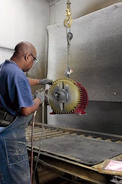

Article 516 of the NEC applies to things you use every day. Walk into your kitchen for example. The metal panels of your range, dishwasher, and refrigerator all underwent finish application operations using equipment compliant with this area of the NEC. The cores of the motors in these appliances were dipped in Art. 516-compliant systems, as were the cores of the motors used in the assembly of these appliances (Photo 1 and Photo 2).
Photo 1. In this manufacturing plant, a motor core is being lowered into a varnish vat. This process is called dipping. Notice you don’t see any raceway in the immediate vicinity of the vat (Photo courtesy of Baldor Electric Co.).
Service trucks, buses, planes, trains, and automobiles all are made with components in their manufacture or finishing subject to Art. 516 requirements. Examples are everywhere, making this part of the Code a pretty important part of the NEC. But what does it say?
Photo 2. Here’s a photo from a sister plant, showing the motor in the vat. Now you can see some raceway, but notice the distance. This provides plenty of room for operations and maintenance (Photo courtesy of Baldor Electric Co.).

Photo 3. This is an example of a hand-held spray manipulator (Photo courtesy of Baldor Electric Co.).
The next Section is 516.10, “Special Equipment”. For the purposes of this Section, the equipment will fall into one of three categories:
1. Fixed. Attached to a mechanical support or manipulator [516.10(A)].
2. Hand-held. Manipulated by hand during the spraying operation [516.10(B)] (Photo 3).
3. Powder coating. Where combustible powders are applied [516.10(C)]. You’ll still apply 516.10(A) or (B), depending on fixed or hand-held. But if it’s a power application additional requirements apply. Mostly, these requirements mean (yet again) to bond equipment to eliminate differences of potential.
