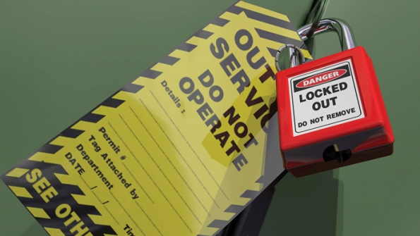

There’s more work involved in protecting yourself than simply slapping a tag and lock on a piece of equipment and starting work. Test for the presence of voltage before you touch! (Artboy Animation/iStock/Thinkstock)

Lockout devices
Each lockout device must meet the seven requirements enumerated in 102.2(E)(3)(a) through (g):
(a) It must include a lock.
(b) It must include a means of identifying who locked it.
(c) It can be just a lock if it is readily identifiable as a lockout device.
(d) It shall be attached in a way that prevents operation of the disconnecting means.
(e) Where a tag is used with the device, the tag must include a statement prohibiting unauthorized operation of the disconnecting means or unauthorized removal of the device.
(f) It must be suitable for the environment and the duration of the lockout.
(g) The key or combination to the lock must remain in the possession of the person installing the lock or the person in charge.
Note that (e) has specific implications under federal law (OSHA). Basically, if it’s your lock, then nobody else can remove it except under special circumstances and following a special procedure with special permission. For example, you left on a week’s vacation and did not remove your lock. The operations supervisor and maintenance supervisor each provide a removal authorization signature once the written prerequisites have been satisfied per the company’s lockout/tagout procedures.
Tagout devices must meet the five requirements enumerated in 102.2(E)(4)(a) through (e). These are aimed at ensuring the tag is going to stay on the lock, stay legible, and be readily identifiable as a tagout means. One way to meet this last requirement is to purchase tags specifically designed for that purpose. If all of your lockout tags have red stripes and the words “LOCKED OUT” on them, their purpose is obvious.
