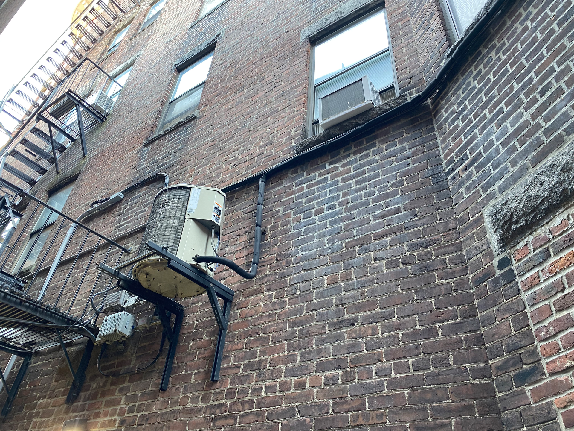

Alley Whoops!
I spotted this installation while walking through an alleyway on a recent visit to a big city near me. The air conditioning unit sitting on the brackets made of strut (below the windows) has no disconnecting means anywhere within sight. Section 440.14 requires a disconnecting means to be located within sight from — and readily accessible from — the air-conditioning or refrigeration equipment. Exception 1 allows the disconnecting means to be located remote from the air-conditioning or refrigeration equipment if the equipment is essential to an industrial process at a facility with written safety procedures and qualified people if the disconnect is lockable in accordance with Sec. 110.25. This is a residential building, so Exception 1 is not applicable. The power for this unit is being supplied by what appears to be a UF cable secured to the refrigerant lines with cable ties. Section 225.21 refers installers to the requirements in Sec. 230.51 when installing multiconductor cables on the surfaces of buildings or structures. There does not appear to be any Code sections that specifically prohibit installing and supporting UF cables in this manner. However, Sec. 340.12(9) prohibits installing UF in direct sunlight unless the cable is identified as being sunlight resistant.
