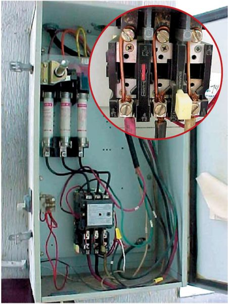

Lack of Overload Protection
All references based on the 1999 edition of the NEC.
Alan Barge, an engineer with Aero Systems Engineering, discovered this dangerous situation while inspecting a major air carrier’s baggage conveyer system at a large U.S. airport. Whenever the conveyer overloaded with heavy bags, the system would stop. This was because someone had defeated the circuit overload protection capability by installing No. 10 solid copper wires instead of approved protective devices as noted in Art. 430. This dangerous installation could have easily caused a fire if it had been left uncorrected.
