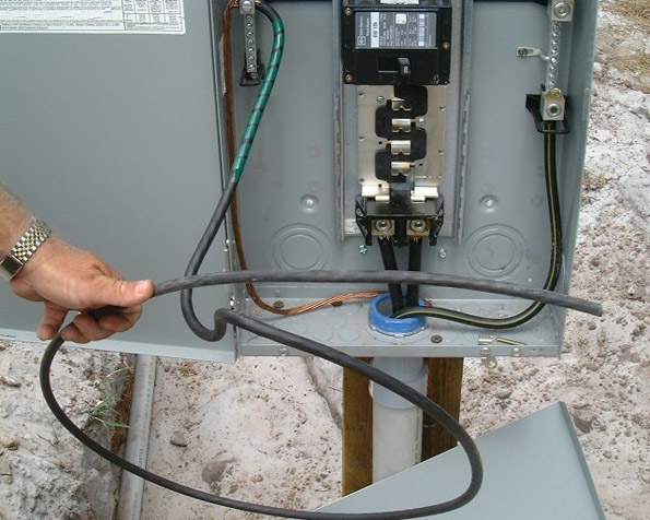

The electrical inspector wasn’t too sure about this installation, so he gave the grounding conductor a little tug and found that the feeder equipment grounding conductor in this rigid nonmetallic conduit wasn’t terminated on the other end. To his surprise, he discovered the same situation at the other end of the conduit. Someone had just stuffed a few feet of cable into the conduit to make it look like it was a proper installation. Per 300.13(A), conductors installed in a raceway must be continuous between outlets, boxes and devices.
