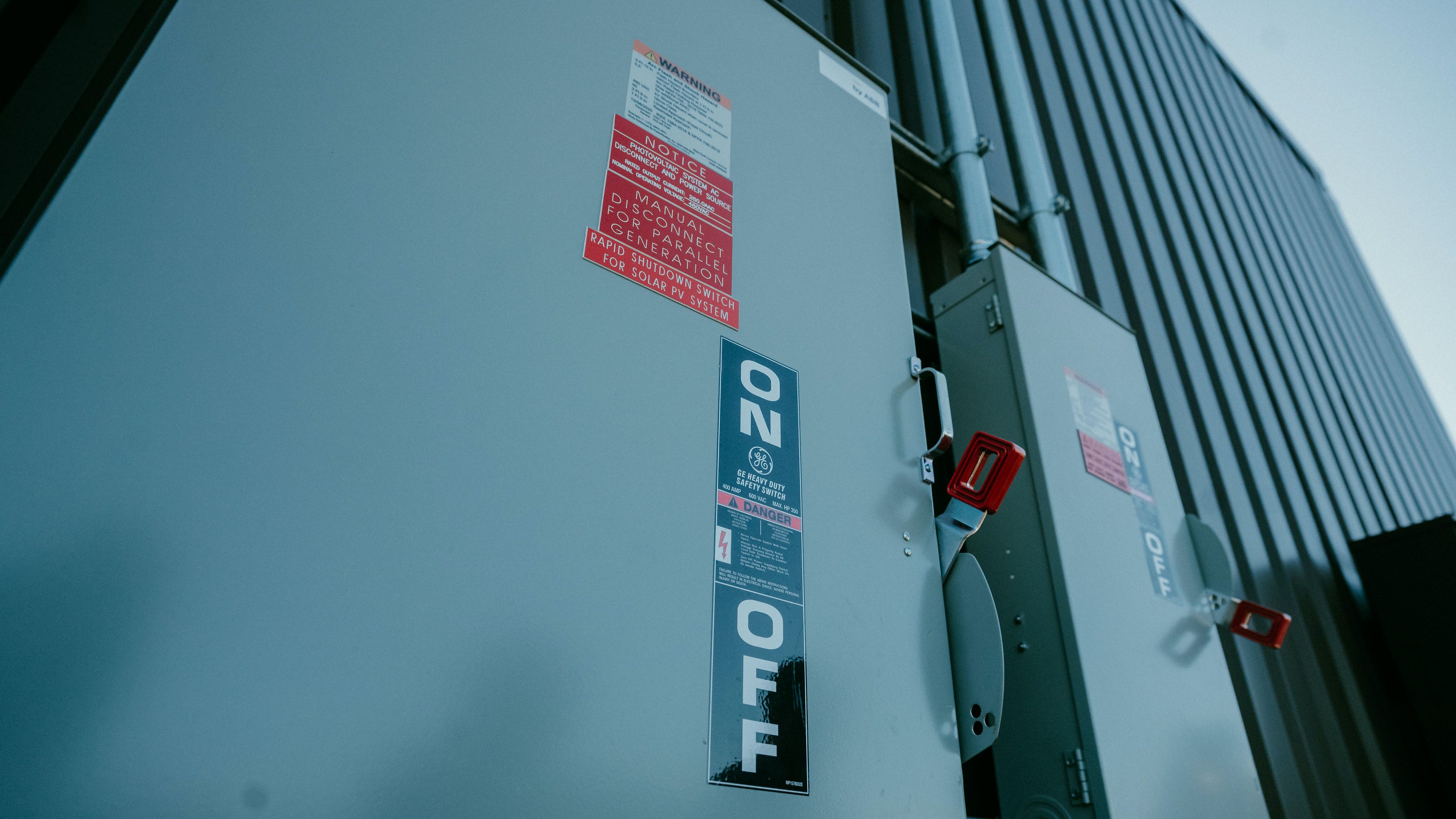

Section 706.15(A) — ESS Disconnecting Means
Disconnects are basically big switches that can be flipped by a technician, utility worker, or firefighter to turn off all or part of an electrical system. A typical ESS will have one or more disconnect switches, with additional disconnects to isolate the PV portion of a system. This usually includes disconnects in the DC and AC portions of the circuitry.
Section 706.15, which is not new in 2023, describes the special requirements for ESS disconnecting means, which are in excess of other disconnects found in the system. Importantly, the language of Sec. 706.15(A) has been cleaned up to make clear that these special requirements apply only to the ESS disconnecting means.
“Means shall be provided to disconnect the ESS from all wiring systems, including other power systems, utilization equipment, and its associated premises wiring.”
This is a welcome change because many inspectors have previously misinterpreted the requirements of Sec. 706.15 to apply to all disconnects in the system. Since this is a clarification and not a change of substance, you may be able to work with a benevolent inspector to avoid misunderstandings and the burden they create — even when the jurisdiction has not adopted the NEC.
Section 706.15(B) — ESS Disconnecting Means Requirements
What are these special requirements for the ESS disconnecting means? There are several. One updated requirement is related to location and control.
“The disconnecting means shall be readily accessible and shall comply with one or more of the following:
“1) Located within the ESS
“2) Located within sight and within 3 m (10 ft) from the ESS
“3) Where not located within sight of the ESS, the disconnecting means, or the enclosure providing access to the disconnecting means, shall be capable of being locked per Sec. 110.25.”
These rules exist to protect technicians working on the ESS by ensuring it does not become energized without their knowledge. Note that the ESS disconnecting means must meet only one of these conditions. The first applies to an ESS that is packaged within a single unit and contains an integrated disconnecting means, which can be the simplest solution for the designer if it’s an available option. Disconnects not within sight and within 10 ft of the ESS must also be lockable per Sec. 110.25.
