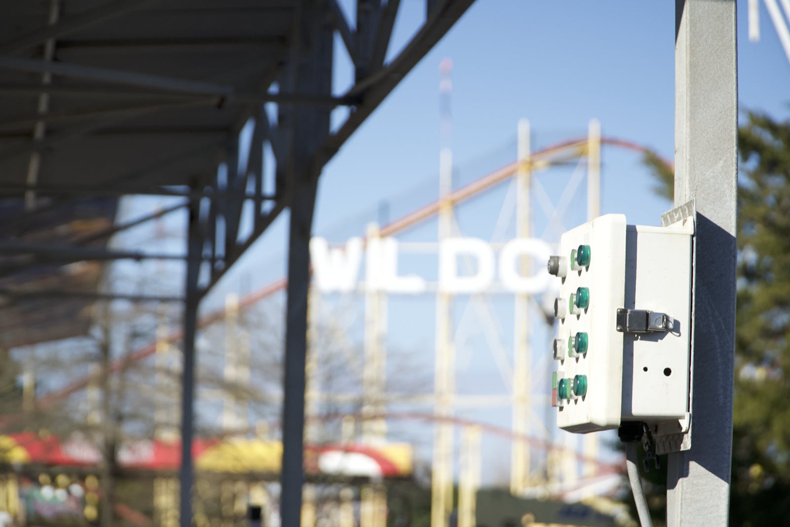

Electricians power every industry within our modern economy — from the hospitality sector to the medical research industry to amusement and entertainment venues. Electricians are needed to power the motors, lighting, and controls in permanent amusement parks and mobile carnivals throughout the country. This article will provide a few tips and shortcuts on how to find the guidelines for installing portable wiring and equipment for carnivals, circuses, fairs, and similar functions. Use this handy guide for installing and repairing wiring in or on units designed to be moved (Portable Structures), as described in Sec. 525.2, which includes but is not limited to amusement rides, attractions, concessions, tents, trailers, trucks, and similar amusement structures/units.

A means to disconnect each portable structure from all ungrounded conductors shall be provided. The disconnecting means shall be located “within sight of” (this is an Art. 100 definition) and within 6 ft of the operator’s station. The disconnecting means shall be “readily accessible” to the operator (also an Art. 100 definition), including when the ride is in operation. Where accessible to unqualified persons, the disconnecting means shall be lockable.
A shunt trip device that opens the fused disconnect or circuit breaker when a switch located in the ride operator’s console is closed shall be a permissible method of opening the circuit per Sec. 525.21 (A), which discusses disconnecting means.
