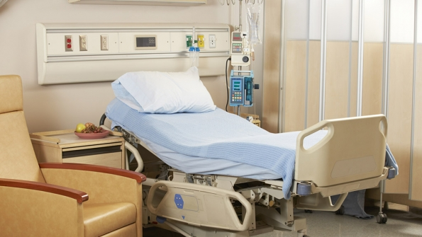

One of the more prevalent misunderstandings I see is the interpretation of patient vicinity versus patient care space. Both include the word "patient," so they mean the same thing, right? Wrong. "Patient vicinity" is defined in NFPA 99: Health Care Facilities Code and reiterated by Art. 517.2 in NFPA 70: National Electric Code (NEC) as "a space, within a location intended for the examination and treatment of patients, extending 1.8 m (6ft) beyond the normal location of the patient bed, chair, table, treadmill, or other device that supports the patient during examination and treatment and extending vertically to
2.3 m (7ft, 6 in) above the floor." So, in simple terms, the patient vicinity is the area within the wingspan of the patient. This definition is intended not only for inpatient functions but also for outpatient services, and is not just limited to a hospital bed location.
In contrast, the patient care space has a much broader range of coverage. The NEC definitions for spaces are derived from the NFPA 99 definitions of "patient care rooms." NFPA 99 defines the general description of "patient care room" with the same words that 517.2 uses for "patient care space” as "space within a health care facility wherein patients are intended to be examined or treated.”
The patient care space encompasses the patient vicinity, but is not limited to the wingspan parameters of the vicinity definition. The article provides further information to clarify basic care spaces, general care spaces, critical care spaces, and support spaces. The categories of spaces define the range of risk to patients or caregivers from “not likely to cause injury" to "likely to cause major injury or death." NFPA 99 also provides Annex material, which is additional explanatory material regarding the space (room) criteria. (As a side note, I always pause when I read these definitions. Not every profession can say they make decisions based on a potential outcome of "major injury or death.")
Why does a clear understanding of patient vicinity and patient care space matter? Like everything else in the code, these terms are used in other sections to inform and implement additional criteria. Where the definition of patient care space and vicinity really affect the electrical design and construction of a facility is in the wiring requirements. Article 517.20 of the NEC indicates that the wiring and protection requirements of 517 apply to patient care spaces of all health care facilities. Article 517.13 further indicates that wiring in patient care areas shall comply with 517.13(A) and (B). Section (A) indicates the branch circuits serving the area "shall be provided with an effective ground fault current path by installation in a metal raceway system, or a cable having a metallic armor or sheath assembly." Section (B) requires an insulated equipment grounding conductor. This means that the entire defined patient care space (not just the vicinity) is required to have a redundant ground path. The intent of this requirement is to eliminate the opportunity for the patient to be the “ground path." (Another side note: NFPA is working on alignment between codes to eliminate the word “area” and instead use the word "space." Again, words matter.)
