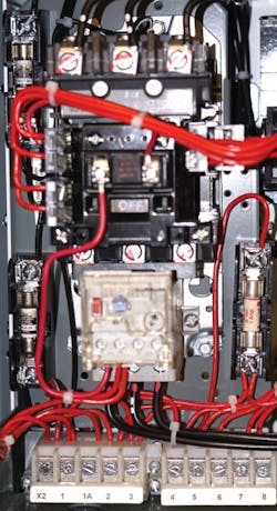

Photo 1. You’re looking at a motor starter inside of a motor control center (MCC) bucket. The primary side fuses of the control power transformer are mounted vertically on the left side of the starter; secondary side fuse is mounted vertically on the right. The control power transformer is mounted behind the motor starter. Terminal connections are brought out to the terminal strip at the bottom of the starter for ease in taking measurements.

The multimeter shown in the Figure helps depict the troubleshooting steps used to isolate problems in the control circuit. One multimeter test lead (typically the black for consistency) is placed at a convenient point on the grounded (i.e., X2) side of the control circuit. The opposite test lead (red) is used to “walk through” the circuit.
Photo 2. The black test lead can remain on X2 while the red test lead is moved to the various terminals on the terminal strip to test for the presence of voltage.
Follow these steps to begin tracing voltage through the circuit:
1) Place the red test lead at point 1 (Terminal 1 of the terminal strip of Photo 2) in the circuit, where power enters the STOP pushbutton. In Photo 2 this corresponds to test leads placed on the “X2” and “1” terminals located beneath the starter. If voltage isn’t present at this point, the fuse is likely open. If the meter indicates voltage is present, continue to the next step.
2) Move the red test lead to point 1A on the schematic (Terminal 1A in Photo 2). If the meter reads zero at this point, then the STOP pushbutton contact is open, and the cause must be investigated and repaired.
3) Move the red test lead to point 3 on the schematic (Terminal 3 in Photo 2). Voltage shouldn’t be present until the START button is depressed. If voltage doesn’t appear at point 3 when START pushbutton is depressed, suspect a faulty start switch.
4) If voltage is present at point 3 and the motor didn’t start, test for voltage at A1 on the starter itself. If voltage is applied to the coil at A1 as expected, and the circuit still doesn’t operate, faulty overloads may be the problem — even though an attempt was made to reset them initially when investigating the main power circuit (see Part 1 of this series).
5) To verify the overload contacts aren’t open, place the red test lead at terminal 95 on the overload relay contacts when depressing the START button. If voltage appears at this terminal, the overload contacts appear to be open as voltage is simply now being read across a set of open contacts. Correct the overload contact problem.
