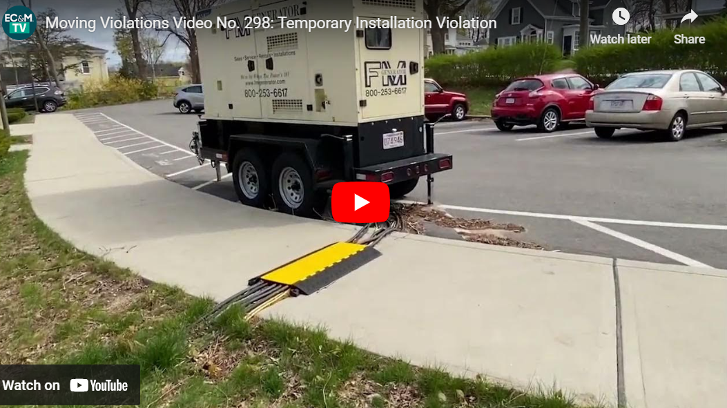

Russ looks at a temporary feeder installation that violates Sec. 590.4(J).
In this episode of Moving Violations, Russ looks at a temporary feeder installation that violates Sec. 590.4(J). The section does not permit cables, flexible cords, or cable assemblies to be lying on the ground like they are in this temporary installation. This type of installation needs to be better protected from potential hazards.
