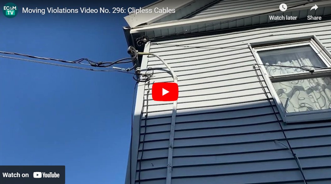

Russ finds some cables installed without any clips.
In this episode, Russ finds some cables installed without any clips. The lack of sufficient clips is a violation of Sec. 230.51(A) which requires service-entrance cables to be strapped within 12 in. of every service head or connection. In addition, the connector appears loose and vulnerable to water or other problems.
