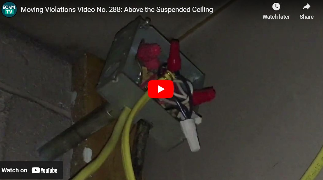

Russ takes us above a suspended ceiling that has numerous Code violations.
In this episode of Moving Violations, Russ takes us above a suspended ceiling that has numerous Code violations. Among the mess of violations, a major concern is the sheet rock that has been taken out but not firestopped, which violates Sec. 300.21. In addition, none of the NM cables have support, which is a violation of Sec. 334.30, and the missing cover on the box violates Sec. 314. 25.
