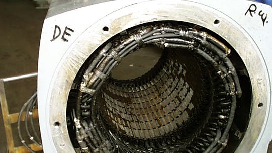

Courtesy of EASA.
Note how the winding of this motor is completely overheated in all phases.

To appreciate the value of RCFA, consider what might happen without it. A good example is the case history of a failed 200-hp (150kW) air compressor motor with a thoroughly overheated winding (Photo on the right). Since the motor’s service factor (SF) was within the operating range of many compressors — and with no other evidence available — the service center logically concluded the cause of failure was an overload/overcurrent condition. After conferring with the end-user, the service center rewound the motor, upgrading its insulation system from class B (130°C) to class H (180°C) to prevent a recurrence.
Unfortunately, the initial failure analysis in this case was cursory. The service center jumped to the conclusion that an overload/overcurrent condition fried the winding without asking what else could have caused it.
Applying the RCFA methodology would have examined the motor’s failure mode, pattern, and appearance as well as its application and maintenance history. RCFA also would have considered the entire motor-drive system, not just the motor. System elements include the motor’s power supply, foundation, method of connection to driven equipment, and the driven equipment (Fig. 1).

Given that background, how did RCFA change the case history of our failed compressor motor? First, recall the information initially available — a motor with an SF rating suitable for its application with thermal degradation in all phases of its winding. Based on this, the service center attributed the cause of failure to an overload/overcurrent condition and rewound the motor with an upgraded class H insulation system to prevent recurrence. When the motor continued to fail after multiple rewinds, including a redesign to a higher rating, the service center turned to RCFA.
As part of the RCFA process, the service center methodically examined the motor and system trying to narrow down possible causes of failure. Following the 5-why approach, they kept asking “why” until they ruled out or identified a probable root cause of failure. For example, when they measured the subject motor’s actual operating current with load and recorded it on the RCFA template shown in Fig. 3, they found it did not exceed the nameplate rating. That led them to look for other reasons “why” the motor’s operating temperature kept getting hot enough to damage the winding, including the possibility of reduced airflow or a restricted ventilation system.
As a result of the RCFA and 5-why process, they discovered that the cooling fan in the compressor enclosure was rotating in the wrong direction. Due to reduced airflow, the ambient temperature was more than 40°F (22°C) above normal, which would be recorded in the blank template shown in
Fig. 4.
As this case history of a compressor motor shows, the initial misdiagnosis of overload as the cause of failure resulted in multiple unnecessary rewind-failure cycles. Once RCFA correctly identified the direction of cooling fan rotation as the root cause of failure, the problem was corrected. That same compressor motor has been operating successfully now for more than a decade.
