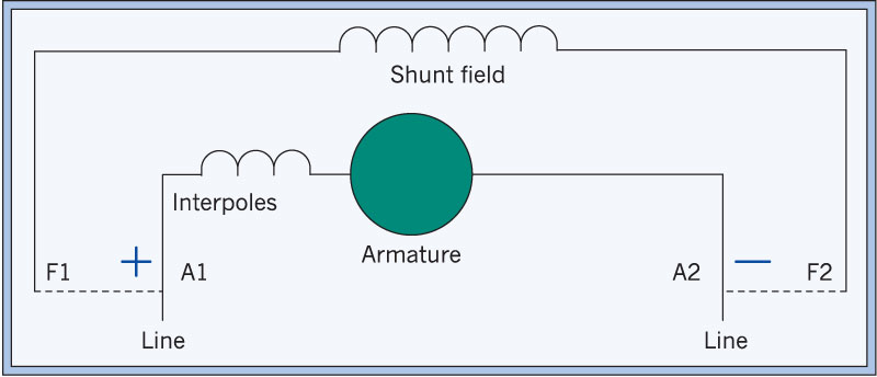

• Replacing a shunt-wound DC motor with an SCIM and VFD
A shunt-wound DC motor (Fig. 1) has relatively constant torque up to its base speed rating. For example, a shunt-wound motor rated 1,750 rpm would have constant torque up to 1,750 rpm. If it were rated 1,750/2,100 rpm, the constant-torque range would extend to 1,750 rpm, above which the motor could produce constant horsepower up to its highest rated speed of 2,100 rpm.
An SCIM has a varying speed-torque curve, and if supply voltage drops during starting due to the locked rotor current, then torque may dip below the values of a shunt motor with the same power rating. This negative feature of operating an SCIM on a utility power supply can be overcome by using a VFD to keep the motor starting current close to rated current.
The type of application also factors into the selection of the replacement SCIM. For example, variable-torque, low-inertia loads, such as pumps, do not require relatively high starting torque capability; thus, an SCIM with the same power rating as the shunt DC motor it is replacing should be sufficient. Other variable-torque loads with high inertia (e.g., fans and blowers) have relatively high starting torque requirements. In such cases, it may be necessary to increase the SCIM power by at least one rating and use a more sophisticated vector VFD. (Note: Shock load applications, such as shredders, may require a VFD with peak current capability that is much higher than standard.)
When converting a constant-torque or high-inertia load application from a shunt DC motor to an SCIM, it is a good practice to verify the motor and drive selection with the VFD and SCIM manufacturers. Some drive manufacturers have downloadable software to aid in the selection of the SCIM and VFD.
