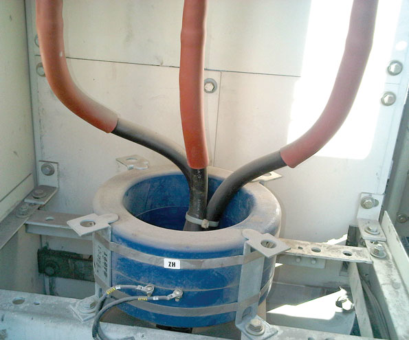

This zero-sequence CT is used to detect ground current in a 3-phase circuit.

Flux-summation method — The flux summation method utilizes a core balance CT, also called a zero-sequence CT, which encompasses all phase conductors. These special instrument transformers have enlarged openings adequate for multiple cables and can either be rectangular or toroidal (Photo). Often, they have low turns ratios and do not require very high accuracy ratings because their primary currents are typically limited by neutral impedances as discussed above. A 50:5A, C10 CT is commonly used in this application. Principally, flux is only produced in the core balance CT when a non-zero net magnetic field results from a current imbalance in the encompassed conductors. This flux will produce CT secondary current.
