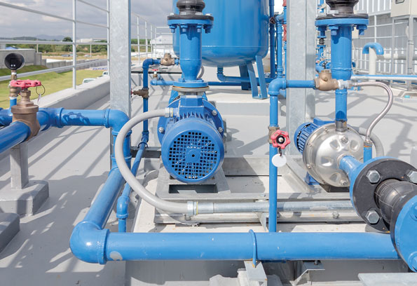

An important step when selecting a centrifugal pump and an electric motor for an application or when troubleshooting operation issues is to determine how much power the pump should be using. The “by-the-book” approach references the pump curve, which shows the power requirement for the pump’s range of operation (head and flow rate). While that’s the best approach, a simple, universal formula based on the relationship of power, head, flow rate, and efficiency can provide realistic estimates for general planning or primary troubleshooting (Fig. 1).
RonFullHD/iStock/Thinkstock
Because the head and flow rate are determined by the pump application, these requirements are calculated during the system engineering stage for new or proposed installations. Ideally, this data is then stored with the asset management system. The head and flow rate data will cover a range of operating conditions, so to accurately assess the power required when troubleshooting existing installations, those values should be measured at the pump site.
A good approximation of the head is simply the discharge head minus the suction head, as measured at the pump with basic pressure gauges. For water, gauge pressure multiplied by 2.31 equals head in feet. Measuring flow rate can be more difficult if the system doesn’t have such instrumentation. In those cases, the most direct method is to use portable instruments with sensors mounted to the pipe surface.
