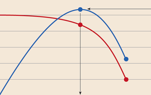

The BEP for a pump is similar (Fig. 3). With the discharge valve closed (“dead head”) and zero flow, efficiency is zero. Opening the valve will reduce the discharge restriction, so flow through the pump and efficiency will gradually increase until it becomes more turbulent. At that point, efficiency will start dropping and continue to drop as the pump approaches “run out” condition. As with traffic flow on a busy highway, somewhere between “dead head” and “run out” condition, the flow rate will be at maximum efficiency (i.e., the BEP).
Fig. 3. This graph presents head and flow rate at BEP.
Note that the BEP in Fig. 3 occurs at a flow rate of about 1,600 units, which coincides with the maximum value on the efficiency curve. That flow rate also intersects the pump curve at a point equal to head of about 220 units.
If pump efficiency changes with flow rate, it’s logical to ask why. As noted earlier, one reason is that pump efficiency directly correlates with turbulence in the flow (i.e., the lower the turbulence, the greater the efficiency). Therefore, the BEP is where turbulence is minimal.
