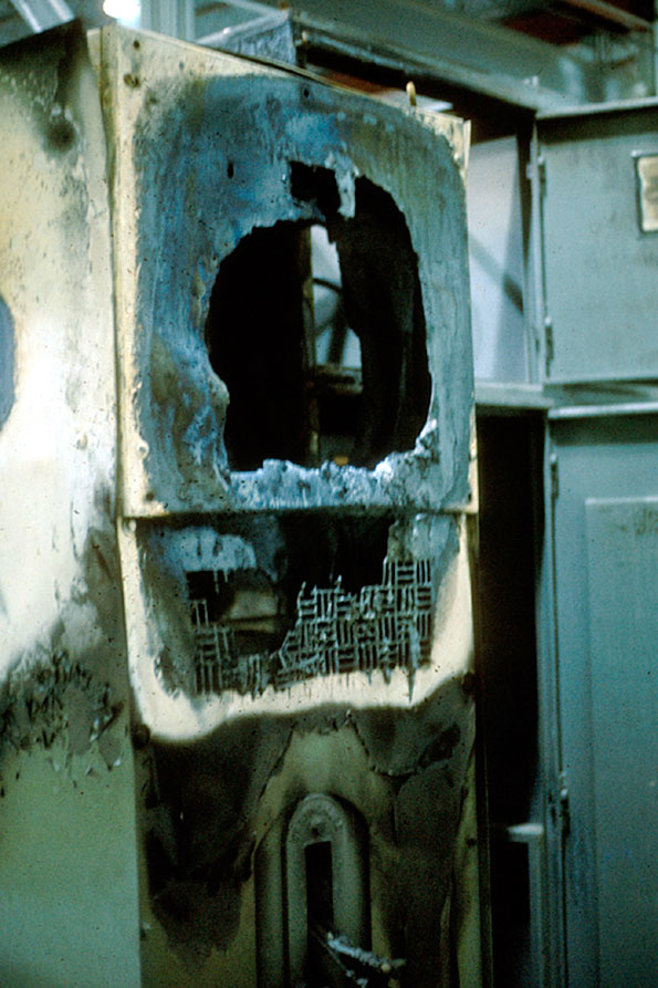

This is the type of damage that can occur due to improper grounding. Arcing between this box and the motor frame it was connected to eventually caused a fire.

Some plants ground the motor frame; others only connect the ground to the J-box. So, if the J-box is solidly grounded but not bonded to the motor, the motor is not really grounded per the National Electrical Code (NEC). The Photo illustrates what can happen when a J-box is not properly grounded to the motor frame (i.e., if both are not properly grounded per the NEC).
