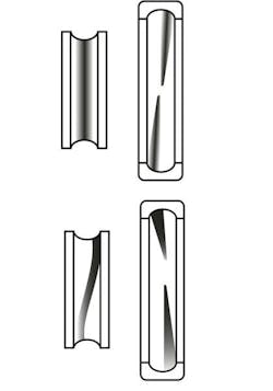

Many of you have good in-house predictive maintenance departments, and others outsource that work to others. Either way, you routinely know when a bearing is deteriorating, and remove the motor from service before it turns into a catastrophic failure. That saves a lot of maintenance dollars, which is great. But if you stop there — without discovering why that bearing is faulty — you could be facing the same problem again in a few short weeks or months. Bad bearings often hold a great deal of evidence, if you know what items to focus on.
Diagonal wear paths indicate misalignment. The load zone of the bearing at top, shown as shadowed path, indicates that the outer race is misaligned to the shaft. The load zone of the bearing at bottom indicates the inner race is misaligned relative to the housing.

  • Misalignment. A diagonal wear path indicates misalignment (Figure).
  • Preloading. If the wear path is offset in opposite directions on inner versus outer race, the bearing was preloaded during service (Photo 1). Are both ends preloaded outward? That means the motor does not have sufficient room for thermal expansion of the shaft. Corrective machining is required. Only the drive end? That means the preload was due to external forces, specifically during the alignment and coupling phase. Give the millwright a heads up.

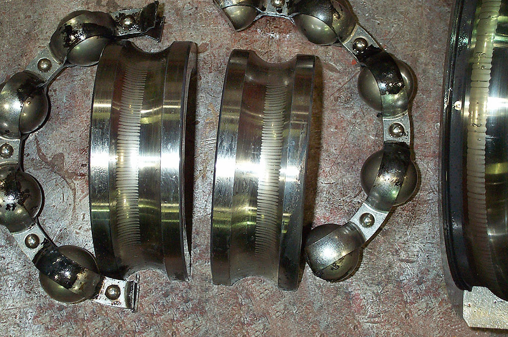

Photo 2b. Bearing fluting due to shaft currents (top) and grease contamination (bottom).
  • Shaft currents and contamination. A washboard appearance called fluting (Photos 2A and 2B) is indicative of shaft currents (a.k.a. bearing currents), which are increasingly common when motors are powered by variable-frequency drives (VFDs). A highly frosted wear path is either caused by VFD-related shaft currents or dirt embedded in the grease. Use a 20x magnifier to look more closely. Electrical pitting on the race or rolling element will have a melted appearance along the edges, whereas contamination causes a rougher cratering.
