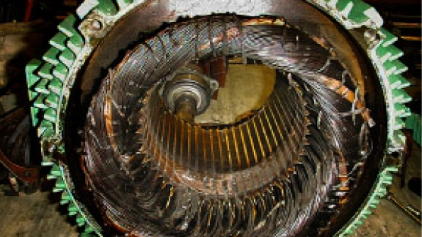

AR100 concisely describes the requirements for a good practice rewind in just two pages, beginning with inspection of the windings (Photo 1) and rotor squirrel cages. It’s easy to forget that the rotor is an electrical component — the rotating secondary of a transformer, with the stator being the primary. This is important, because defective rotor bars or end rings (Photo 2) could reduce output torque or cause vibration.
