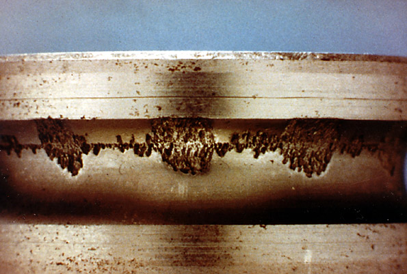

The damage shown here corresponds to the spacing of the rolling elements. It started as non-rotating vibration during shipping or storage.

Bearings — ambient vibration. Motors can be damaged by vibration even when they aren’t rotating. Proximity to rail lines, busy roads, and/or production floors can all contribute to the ambient vibration. Even low-magnitude vibration, over time, can damage bearings while they’re stationary (e.g., false brinelling). One mill solved the problem of ambient vibration from nearby machinery by storing motors on worn out conveyor belting that otherwise was destined for a landfill.
False brinelling causes uniformly spaced damage along the bearing race that matches the spacing of the rolling elements. Although initially it may appear slight or even invisible to the naked eye, the damage often progresses rapidly when the motor is placed in service (see Photo). Corrosion staining can also result if moisture collects between the balls and races.
Shaft rotation. Motors in long-term storage should have the shaft rotated at least monthly to prevent false brinelling and inhibit corrosion by redistributing lubricant on machined surfaces. Larger, 2-pole machines require more frequent attention than smaller (NEMA-frame) machines.
