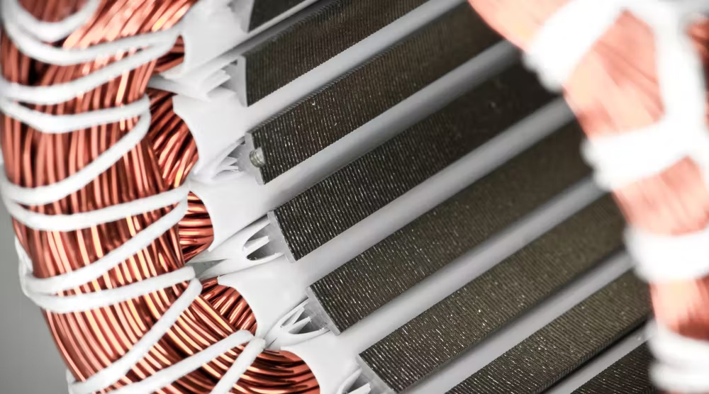

Question No. 1: Armature, field, rotor, stator: which is which?
By definition, the stator comprises all of the nonrotating electrical parts of a generator or motor. Also by definition, the rotor includes all of the rotating electrical parts.
The field of a machine is the part that generates the direct magnetic field. The current in the field does not alternate. The armature winding is that which generates or has an alternating voltage applied to it.
Usually, the terms "armature" and "field" are applied only to alternating current generators, synchronous motors, DC motors, and DC generators.
Alternating current generators. The field of a synchronous generator is the winding to which the DC excitation current is applied. The armature is the winding to which the load is connected. In small generators, the field windings are often on the stator, and the armature windings are on the rotor. Most large machines, however, have a rotating field and a stationary armature.
A synchronous motor is virtually identical to a synchronous generator. Thus, the armature is the stator and the field is the rotor.
DC machines. In DC machines, both motors and generators, the armature is the rotor, and the field is the stator. Because the armature is always the rotor on DC machines, many electricians and engineers mistakenly believe that the armature is the rotor on all motors and generators.
