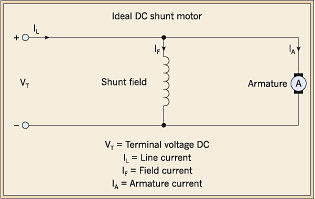

Fig. 1. The shunt DC motor has the field winding in parallel with the armature.
The shunt DC motor has the field winding in parallel with the armature (Fig. 1). In a parallel circuit, the magnitude of voltage drop across each parallel element is the same, while the magnitude of current through each parallel branch is a function of the impedance of the element. Please note: In a purely resistive circuit, the impedance will equal the resistance as there is no reactive component present. Shunt motors are also called constant speed motors, as they provide relatively stable speed and torque characteristics under load.
