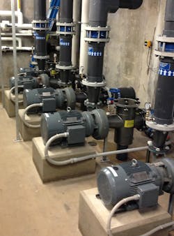

Motor efficiency
The Energy Policy Act (EPAct) became effective in 1997. EPAct requires 1-hp to 200-hp general-purpose motors sold in the United States to meet minimum efficiency levels, referred to as EPAct levels. The U.S. Energy Independence and Security Act (EISA), effective December 2010, updated EPAct efficiency levels for 1-hp to 200-hp motors and established minimum efficiency levels for most 201-hp to 500-hp motors.
Monitoring the power use of motors can determine operating costs and efficiency improvements.
Motor efficiency is the ratio between the amount of mechanical work the motor performs and the electrical power it consumes to do the work, represented by a percentage. A higher percentage represents a more efficient motor. Electric motor efficiency is dependent on (but not limited to) design, materials, construction, rating, load, power quality, and operating conditions.

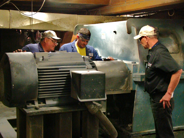

I recently conducted a motor system, PF improvement project at a small industrial process plant with a significant amount of large motor load. At the time of the study, the aggregate plant peak demand was 480kW with an 85% PF, resulting in a $276 average monthly electric utility PF charge.
Measured data shows that power factor (PF) is lower when a motor is under-loaded.
The objective of the project was to identify motors contributing to the less-than-desirable PF and improve the plant PF to avoid future PF charges. A process line, consisting of five induction motors (75 hp, 150 hp, 200 hp, and two at 125 hp) was identified to monitor the power use and PF of each motor in the process during a normal production cycle. A power monitor collected the data, and its associated software package was used to analyze the data. The Table shows a summary of the monitoring findings.
The power monitor measurements indicated all of the motors were under-loaded, which was driving the motor PF on M1 and M2 significantly below the nameplate rating. The findings also suggested the entire process line is oversized based on normal production. Under-loaded motors operate below nameplate PF, as seen in the Figure.
Under-loaded motors can operate below nameplate power factor (PF) rating.
System improvement measures
To avoid electric utility PF charges, the plant needed to be at or above 90% PF. After careful analysis, discussion, and consideration, it was decided to reconfigure the process in a way that would allow 75-hp motor M1 to be removed. M1 was only 41% loaded and using inductive kVAR at 63% PF. There would also be some diversified kW demand reduction and possible energy savings by removing M1. Although demand and energy savings were difficult to calculate because the work that M1 was performing was transferred to motor M4 in the process, M4 had capacity to absorb the load from M1. There was also potential to improve the efficiency and PF of M4 with the load addition, effectively reducing the inductive kVAR contribution of M4.
Another improvement to the motor system was analyzed and determined to be a cost-effective measure to implement. It was decided to add 50 kVAR of capacitance at 200-hp motor M2. Based on the loading and PF measurements of M2, adding the capacitive kVAR would not correct the M2 PF above 90% but would provide enough capacitive kVAR, along with the M1 and M4 improvements, to bring the overall plant to 90% PF.
The results
The improvement measures implemented resulted in a plant PF of 93%, eliminating the $276 monthly PF charges. The measures also resulted in an average monthly plant peak demand reduction of 10kW — a $90 monthly savings. The project payback was less than 18 months. Note: The plant had an existing, functioning 200 kVAR fixed capacitor in place at the main electric service entrance for PF support before this project began. This capacitor remains in place.
