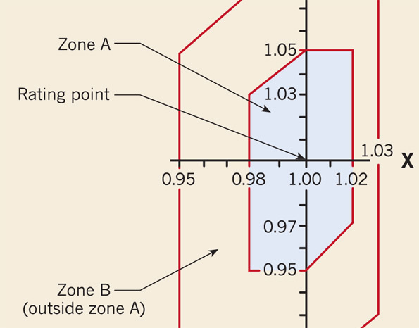

Voltage and frequency limits for IEC motors (Ref.: IEC 60034-1, 7.3 Figure 12).

IEC (voltage and frequency variations). IEC Std. 60034-1-7.3 also addresses deviations from rated voltage and frequency, although it takes a different approach than NEMA Std. MG 1. The IEC standard considers the combined (not individual) effects of voltage and frequency variations. It also presents rated voltage and frequency tolerances graphically, with Zone A being more restrictive than Zone B (Figure on page 12). Machines in Zone A must be capable of producing rated power but, as in NEMA Std. MG 1, they “need not comply with its performance at rated frequency and voltage.” In this regard, the IEC standard (not surprisingly) cautions that the temperature rise may be higher than at rated voltage and frequency.
Zone B is clearly not intended for ongoing operation. According to IEC Std. 60034-1, operation outside of Zone A “should be limited in value, duration, and frequency of occurrence.” The standard also suggests the possibility of de-rating motors for operation in Zone B.
The tolerances for zone A are ±5% for variation from rated voltage; for Zone B, the voltage tolerance is ±10%. The frequency variation tolerances are ±2% for Zone A; for Zone B, the tolerances are +3% and -5%.
