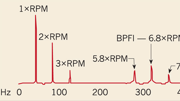

Occurrence of sidebands
Another identifying characteristic of bearing vibration is the presence of sidebands — a series of equally spaced peaks on either side of the bearing fault frequency that are caused by amplitude modulation of that frequency. For example, the vibration amplitude will increase as a flaw on the inner race rotates into the bearing’s load zone (at the bottom for most bearings) and decrease as it leaves the load zone. The spacing of the sidebands (1 × rpm in this case) is referred to as the delta frequency (see Figure). Similar modulation can occur with other bearing fault frequencies at various delta frequencies. For instance, when a flaw is on the rolling element, a fundamental train frequency (FTF) delta frequency is possible.
Spectrum of inner race flaw

The presence of families of non-synchronous vibration in the 2 × rpm to 20 × rpm range, including sidebands, is a strong first indication of bearing vibration that can be confirmed with accurate data on shaft rpm and bearing geometry. Inaccurate data, on the other hand, will lead to erroneous conclusions.
