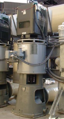

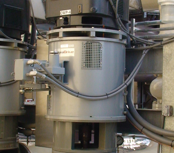

High vibration is a common problem for motors installed on top of vertical pumps. Its source can stem from a mechanical issue with the pump, motor, or coupling — or even hydraulic forces from the pump. Structural issues involving “reed frequency” resonance often amplify the problem, but effective diagnosis must begin with an understanding of the underlying vibratory forces. Although the general category of vertical pumps includes submersibles, this discussion focuses solely on the ones that most commonly exhibit high vibration conditions — surface-mounted pumps that have the motor bolted to a pedestal on top (Photo).
