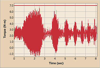

Dynamic test equipment can be set up to track torque data, including torque level and periodic fluctuations known as “torque ripple.” These torque signatures are visible pictures of the load's operational condition and offer insight into the stresses subjected on the motor's rotor. Monitoring and trending torque as a function of the everyday operating condition of a motor is essential when separating electrical concerns from mechanical issues. Bearing faults, variable-frequency-drive-related problems and many mechanical issues can be seen and diagnosed via the torque spectra (Fig. 1).
