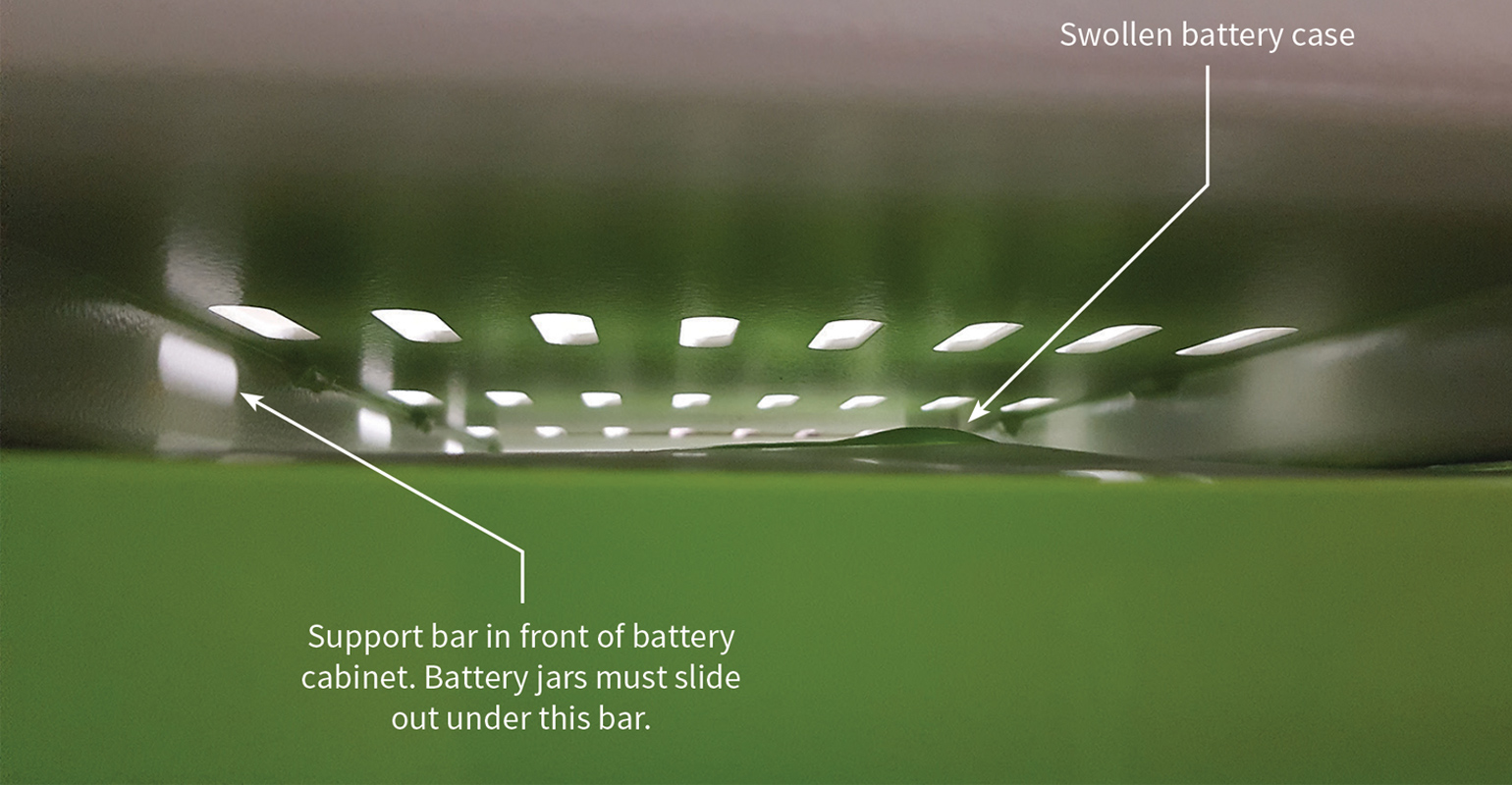

One case in point involved a customer that experienced a loss of power to its critical load in August 2017 when a line of thunderstorms moved through the area, resulting in an electric utility power outage. When a battery failed in the UPS system, it brought operations to a standstill.
This customer had a 200kVA uninterruptible power supply (UPS) system supported by a single string of 800Ah VRLA batteries installed in 2011. In 2016, our company recommended the batteries be replaced due to age. In March 2017, we recommended the plant (all strings, jars, and cells that make up a battery system) be replaced because internal ohmic values documented during the semi-annual preventive maintenance program showed a significant increase in value. Table 1 is a comparison of the baseline readings from 2011 and those collected in March 2017.
As the thunderstorms moved through, and the critical load lost power, a technician was dispatched to determine the cause of the failure. When he arrived on-site, he found the UPS system in bypass mode and the critical load supported by electric utility power. The technician recorded the internal ohmic value and voltages of all jars, noting that several had failed (Table 2).
The technician also noted several jars had swollen so badly that they could not be removed without cutting the cabinet apart (Photo). To repair the system and return it to operation, all of the batteries would need to be replaced. A new cabinet would also be required, increasing the cost and complexity of the plant replacement.
When batteries are in stock, they can be ordered and installed within several days. Unfortunately, this particular battery had a lead time of 90 days. To compound the problem, the cabinet was built specifically for this model, and there was no alternative with the same form and fit. The only option to return the UPS system to service was to install a temporary plant rented from a local battery vendor.
The cost to replace the batteries in March would have been $40,000. After the failure (in August), with the expenses of rental batteries, a new cabinet, and additional labor, the total cost exceeded $70,000, which doesn’t include financial impacts from the loss of critical operations.
